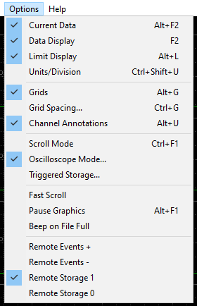

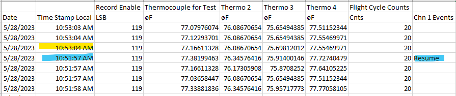

I have "Remote Storage 1" enabled in WinDAQ and recording is starting and pausing based on the input on D1 of the DI-2008 as expected. However, the timestamp of data on resume of recording is in the past. I can see this while browsing the recorded data on the timeline and when exporting to Excel. Looking at the timeline, time is good until remote record input goes low. The timestamp is immediately in the past. Notice the last timestamp before remote recording input was taken to a low input in the Excel image below. When the input was taken high again recording resumed, but timestamp was in the past. I have tested this through several cycles of pause/resume recording and the timestamp goes backwards each time. And the longer it runs the timestamp continues to get further behind actual time. My assumption is there is a setting that I am missing but I cannot find anything in the documentation or online about it. Suggestions?
WinDAQ Options settings.
