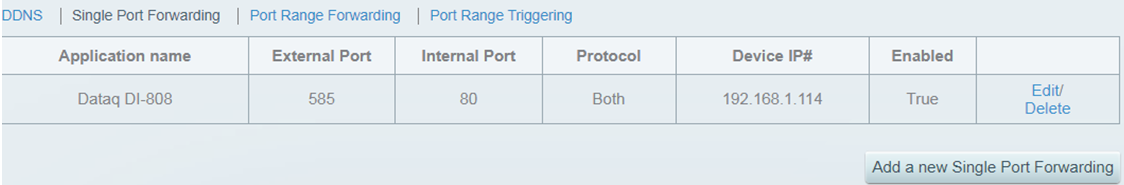

I managed to get the dataq connected to my local network and can now access it via my router! I switched it to DCHP on the dataq and set up a dchp reservation on the router. Its ip is now 192.168.1.114. The next step to be completed was to figure out port forwarding and translation to access it on the internet.
Any ideas on what ports to choose for port forwarding based on the article https://www.dataq.com/blog/data-logger/use-the-di-808-data-logger-from-the-internet/ ? I have tried multiple things including the screenshot of the previous message. When I try to access from outside my local network I type 65.87.55.169:585 for example and havent had luck yet. Am I doing that right?
