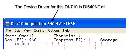

DI-710 Ethernet: DI64?NT.DLL
DI-718 Ethernet: DI67?NT.DLL
DI-710 and DI-718 Ethernet device drivers are in the order of WinDaq/IP installation - look in the title bar of WinDaq Acquisition when running the device to determine your dll.
